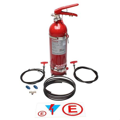

just ran this one by Charlotte (Tech) and she gave it a green light. Looks like it will literally replace my handheld in the bracket then just plumb it.
Bumble
@Bill-F, that’s a good system, but, in the event you didn’t note it already, it’s water-based foam, so it will cause a mess particularly with electronics if you ever have to use it or accidentally use it. For damage and cleanup, along with some other reasons regarding the physics of the agents, I prefer a gaseous system.

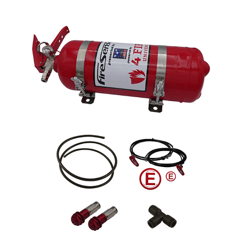

However, they make a 5 lb. system not much more in price than the Lifeline foam system you’re considering. They also carry FIA systems if you prefer them. Here are the links:
10 lb system: SPA Technique 10lbs FireSense+ Fire Suppression System - SFI 17.1
5 lb system: SPA Technique 5lbs FireSense+ Fire Suppression System - SFI 17.1
If I’m reading it right, their “Firesense” product is the same AF3 water based foam
@Bill-F, that’s a major question I was going to call Spa to clarify since I’ve been told by multiple non-RMVR people they offer gas systems, but all the info I’ve found is that the 4Fire product is AFFF. If you sort that before I do, please let me know. Otherwise, I’ll be looking for another gas system.
what I have found since is that most the cheapest “gas” 2 nozzle systems start right at $500. ALTHOUGH… I did find a 5lb gas system from ESS at Miatacage.com for $413 so looking strongly at that system for the moment.
ok - never mind. I dug deeper and found that it too is AFFF but their write up on it says its odorless and residue free. So not sure just what it is…
Hmm, residue free? I’d probably have to see that to believe it. I’m hoping between our (and others’) efforts we can find an SFI/FIA gas system at a decent price.
